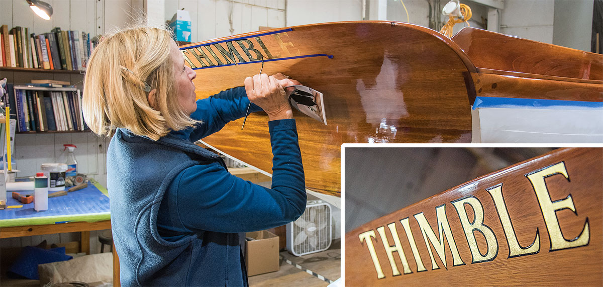

Applying gold leaf.
In the spirit of tradition, Joan Perkins combines modern technology with ages-old techniques to apply the name to THIMBLE’s transom.

Of the nearly endless typefaces, styles, and methods of lettering available, the new owner decided to stay true to tradition and have the name gilded with hand-laid gold leaf. The artist chosen for the job was Joan Perkins of Padanaram Sign Shop in New Bedford, Massachusetts. With nearly 10 years of gilding experience, Perkins is one of the best in the trade.

Photo 8—With a light touch, carefully apply the gold to the surface. While keeping the tissue-paper backing in place, lay the gold on the letter and lightly tap the paper with the side of your thumb. Go over the gold with the tissue paper a second time, a bit more firmly. Watch for cracks, wrinkles, and tears, which are often caused by applying too much pressure.
