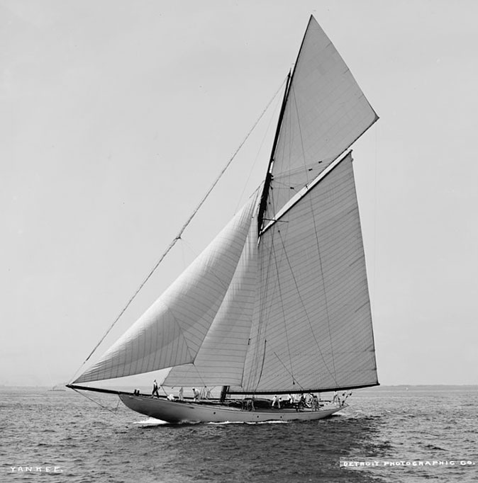

Photo of the NY70 YANKEE sailing
The NY70 YANKEE sailing with her jackyard topsail set. From the Library of Congress, LC-DIG-det-4a15407.
A jackyard topsail is rarely seen today, and there is good reason for that. The jackyard topsail is a sail with murder on its mind, swinging long spars along the deck, intent on sweeping the crew overboard. If you see a jackyard topsail set today, such as on the P-boat JOYANT or on the NY50 SPARTAN, you should take notice, because under a jackyard topsail lies a brave captain and braver crew, whose full attention will be on that large sparred piece of canvas hoisted high into the sky. In the image of the Herreshoff NY70 YANKEE (above) the jackyard is nearly as long as the gaff. The jackyards on RELIANCE’s topsail, shown in the Library of Congress photo below, were 68′ and 58′ long according to the Herreshoff Museum archives. Imagine swinging the unstayed mast of a 50′ sailboat along the deck while under way… that’s what a jackyard topsail would feel like to those handling it on deck, two of them.
