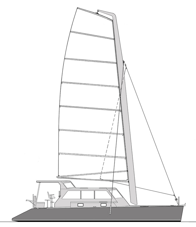

A Catamaran.
Sharpie Cat 42 Sail Plan.

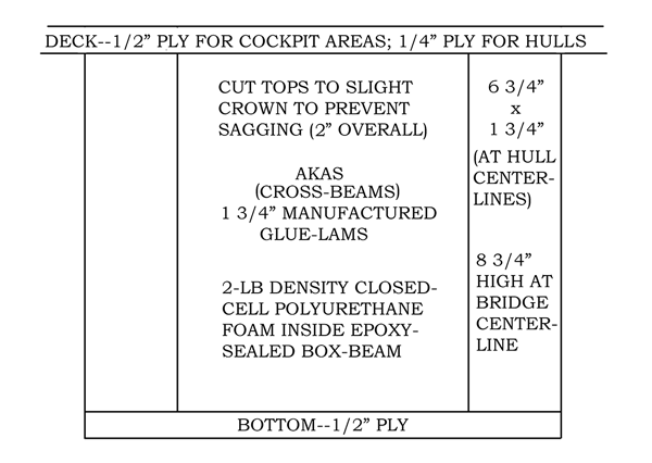

Hence I decided years ago that I would start designing cruising multihulls. I first designed a 40-foot fast cruising trimaran in 2003, the prototype of which is being built (very slowly) in North Carolina. I also started a design for an ultralight, ultramodern 60-foot cruising catamaran, but never completed it. Then, in 2012, I had a brainstorm for a cruising catamaran concept: Make the hulls using cold-molded full-sheet plywood with flat bottoms and radiused chines—essentially modified sharpie hulls—but with deep V shapes forward. I worked for many weeks on this design, creating many more pages of drawings than I typically do. I employed several innovations in the design, including my “L-Head” rotating wing mast (See Blogs #9 and #10), and the employment of manufactured glue-lam beams in the cross-beams (Akas).
Cross beam section
Sharpie Cat 42 Cross Beam (Aka) Section.

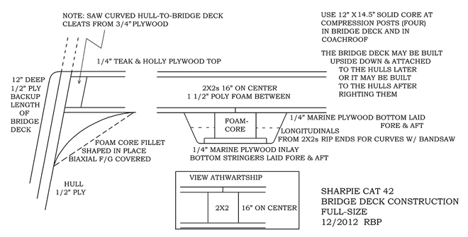

One of the chief weaknesses I see in most cruising catamarans is their bridge deck configuration, shape, and especially clearance above water. Particularly in manufactured fiberglass cats, the clearance is often less than 18-inches, which seems inherently unsafe to me. In any real seas, these low-clearance structures can get severely hammered. A girlfriend of mine once sailed from Key West to Cuba on a catamaran, and feared for her life when the vessel got out in the Gulf Stream and threatened to come apart in seas that were of average (four to six feet) height! In my new design, I therefore strove for very strong foam-core deck construction employing bi-directional structural members, with a clearance of 1′ 10 ½″.
Bridge deck to hull joint at the cockpit.
Sharpie Cat 42 Bridge Deck to Hull Joint at the Cockpit.

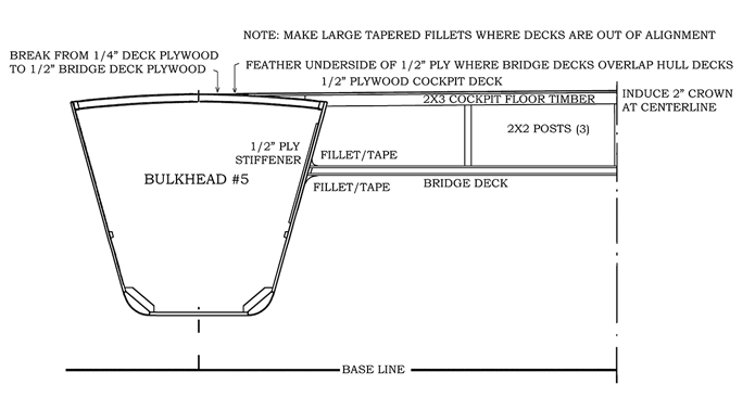

I asked my engineer, Tom Lokocz Adams, to review my structural connections, and on his recommendation I added plywood laminates inside the hulls adjacent to the bridge deck connection points. I designed my bulkheads to be made using 3mm plywood laminated over 1 ½″ closed-cell polystyrene foam. I also designed decks, cabin sides and coachroofs to employ foam cores. For polystyrene foam-core material I have had excellent results using Dow and Owens-Corning residential insulation products. These glue to plywood with epoxy, creating very light, very strong structures, at very low cost.

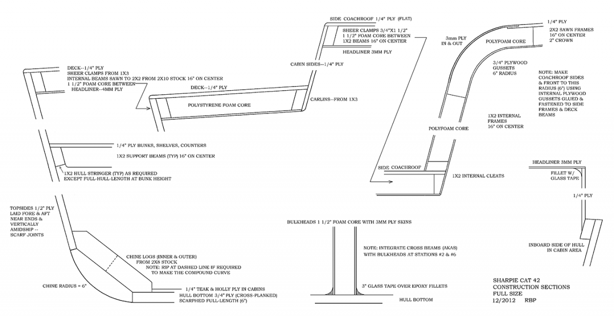

I designed my radius chines to be made from two laminates of solid wood—Douglas fir or spruce—with rabetted corners formed by the laminates to receive plywood planking (see the Construction Sections drawing below). All plywood in the boat should be high-quality marine-grade mahogany such as Shelman or Okume products. Headliners and cabin sides are specified to use 3mm. Hull sides and bottom planks (½″ and ¾″) are scarfed full-length. The main cabin bridge deck is foam-core with internal 2x2 athwartship beams. Outside, underneath this structure are box-beam-stiffeners running fore & aft. I designed a tapered center-deck structure extending forward of the cabin, which joins the forward aka and supports the forestay, dolphin striker and anchor rollers. The V-shaped bottom of this structure is intended to divide waves before they strike the rounded front of the bridge deck. The aft cockpit deck is hollow, providing space for pumps, electrical devices, plumbing, batteries and stowage. Four large solar panels on the hardtop will provide for all electrical needs, including refrigeration. All tanks are integral.
Bridge deck construction drawing.
Sharpie Cat 42 Bridge Deck Construction.
For foam-core components (including the cockpit hardtop), I call for internal structural members from spruce 2x2s and sawn spruce beams 1 ½″ square. I wanted rounded sections for the cabin side-to-top joints, but also designed a simpler section (not shown) that would be less labor intensive.
I designed NACA foil-shaped daggerboards and kick-up rudders, for performance and beach-ability. The daggerboards are intended to break before rupturing their boxes, and are of plywood and foam-core construction. It would be prudent to keep a spare on board. The sharpie cat, with her flat-bottom hulls, can be pulled up onto the beach for maintenance using PVC pipe rollers.
Construction sections.
Sharpie Cat 42 Construction Sections (select image to enlarge).
