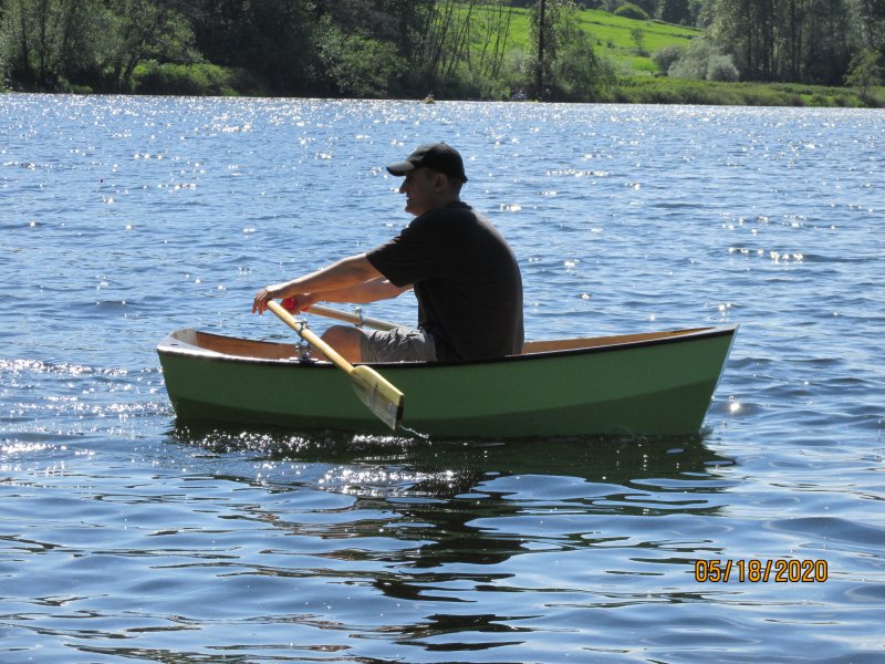

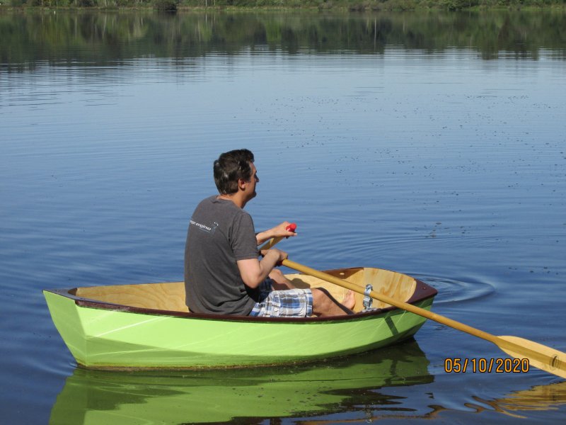

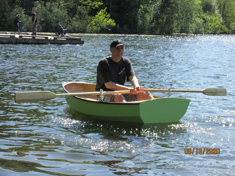

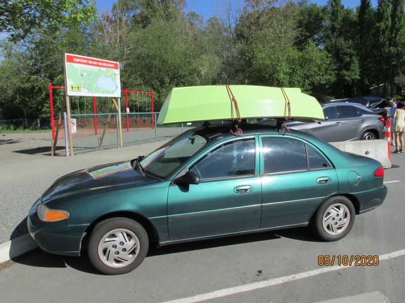

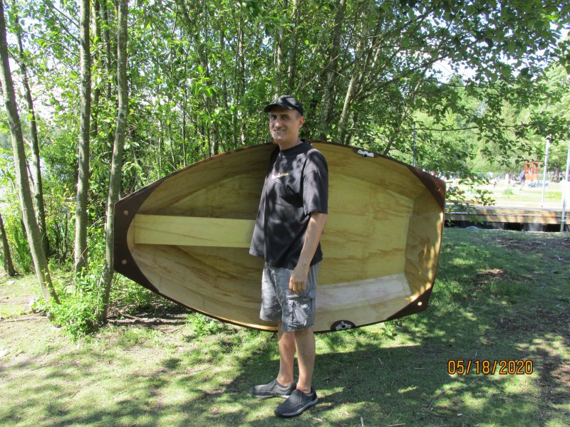

With a length of 6′-6″ (2m) “Dingo” is our shortest boat weighing only 28lb (13kg). Easy to car top, easy to take to the water and back, easy to launch from the mothership without breaking your back. With a beam of 4′ (1.20m) the boat is stable enough to stand up in. It moves swiftly across the water and is very maneuverable. All parts of the boat fit on two sheets of ¼″ (6mm) exterior grade plywood. Nesting of all components is shown to minimize waste. Stitch and glue construction with 3” (75mm) fiberglass tape in epoxy along the seams inside and out. A small outboard not more than 1.5HP or an electric motor can be mounted on the transom. In that case the addition of emergency floatation underneath the bench is recommended. A bench for a passenger can be added in the stern or even better a full length transom to transom longitudinal seat can be installed. It will allow for better distribution of crew weight in order to keep the boat properly trimmed. If the boat is going to be used by two people then a second pair of oarlock sockets will need to be installed further forward. Maximum crew plus gear weight should not exceed 400lb (180kg). “Dingo” is a very suitable boat for fishermen, birdwatchers, nature photographers or as a tender of a bigger boat. It can be built for less than $300 CAD (2020). Here is the bill of materials:
