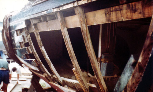

When I finished my summer job at South Street, I sailed FISHERS HORNPIPE to anchor off City Island, and went to work on the Malabar Junior for Tony. She was a basket case, and only a man who dearly loved old things, was not afraid of major projects, and had a keen eye for beauty would attempt saving her. Tony and I saw eye to eye on all of this. The boat was in Sonny’s Boat Club, an amazing collection of nautical junk (er—memorabilia), on the northwest corner of City Island, and I rowed to work each morning in my dory GANDY DANCER.
Starboard bow.
The Malabar Junior in fall of 1981, starboard bow.
Starboard stern.
Starboard stern.

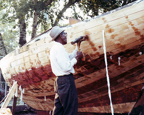

I had two bright young men with me—first mate Paul Newman, who had been sailing with me since Costa Rica, and his best friend Eliot Greenspan, who had joined us in Key West. I had been teaching them boat carpentry, and the three of us dove into Tony’s project. During that fall, after a major clean-up and re-organization (the most critical first steps in any restoration), we replaced some frames, re-planked the hull, and built a new deck, using fabric/epoxy covered marine plywood over sawn oak beams. Tony found an 85-year-old retired caulker from Barbados to caulk the hull, and he did a beautiful job.
Photo of Chris.
Chris, a retired caulker from Barbados, caulking seams.
After caulking, we paid the seams, applied red lead primer below the waterline, and buttoned up the project up for the coming winter. We left Tony with a long list of work instructions to follow, and sailed the HORNPIPE to Maine, where Eliot told me, walking through the autumn leaves, that we would soon have to buy boots (we all wore nothing but sandals). On that note, we turned tail and headed back down into the Caribbean, sailing as far south as Grenada (near South America).

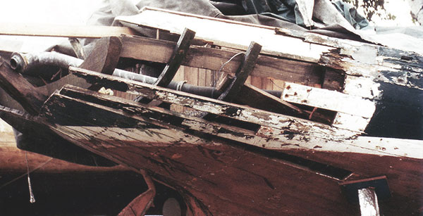

Then, in 1989, I received a call from Tony telling me that IMAGINE had been wrecked during an early fall gale. He had her salvaged, put her on a trailer, and sent her to me in Port Salerno, Florida, where I was ensconced in a small boatyard, designing a new sportfishing powerboat for Armor Craft.
The badly wrecked hull.
IMAGINE wrecked on the rocks after an early fall gale in New York.

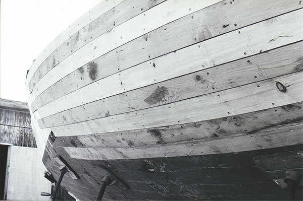

The hull was badly wracked during her days of pounding on the rocks, and all her caulking had started. The interior had been partly submerged, including the engine. She was in very bad shape… a basket case all over again. Luckily, she was insured… unluckily, the insurance money would not even begin to cover what needed to be done.
Re-framed and re-planked.
IMAGINE’s damaged side, re-framed and re-planked.
Nevertheless, I launched into another major restoration, electing to re-plank the hull using cold-molded wood and epoxy, after first replacing many broken frames and carvel planks. I built a steam box, replaced the frames, and re-planked much of her port side, including the deck, which had been destroyed right to the cabin side. I had my third “wife” Beth Stevens with me, an excellent boat worker, and my boatbuilding partner Bill Smith commuted from Ft. Pierce to work with us.

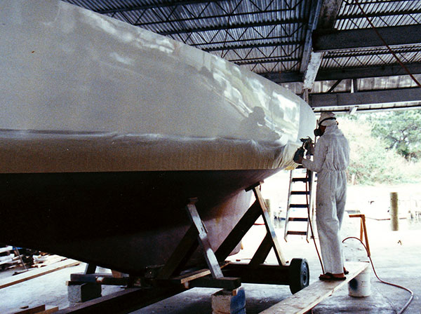

The project was a major one, involving extensive structural and cosmetic repairs, encapsulating the cast iron keel in fiberglass, fabric/epoxy covering hull and decks (I used 4.2 oz Xynole-polyester cloth), re-painting, and creating a “dry bilge” necessary with cold-molding the hull. We had to scrap the old Hercules engine, and because there was no money to replace it, IMAGINE became a true sailboat.
Repainting.
Repainting IMAGINE’s topsides with linear polyurethane.
