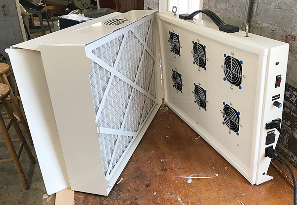

The tool is, essentially, a steel box measuring 25″ wide × 16″ tall × 7″ deep. It weighs 20 lbs, and has a suitcase=style handle on top for easy carrying. Inside that box are six fans whose speed can be adjusted, and two filters. The fans move air up to 535 cu ft per minute (cfm). (Shop vacuums are generally below 200 cfm; anything over 350 is considered the high-volume airflow typical of dust collectors.)

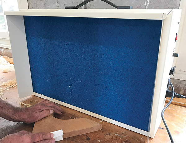

The BenchTop DC arrives mostly assembled, with its two fiters—a coarse MERV-5 prefilter that can be washed and reused, and a primary MERV-15 filter that cannot—already installed. The primary filter is 16″ × 25″× 3″, and replacements can be sourced through Oneida, at online outlets, or at most hardware stores. This filter is rated to remove particles as small as 0.3 micron, which includes bacteria and cooking smoke (though the Benchtop DC is not designed to remove these) as well as fine wood particles. (MERV means “minimum efficiency reporting value,” and is a measure of the size of particle a filter will collect. MERV 15 is at the fine end of the scale.)
Replaceable filter
The blue surface is MERV-5 prefilter that’s washable and reusable. Fine dust is collected by a replaceable MERV-15 filter.

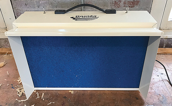

Setting up the newly arrived collector required the application of three self-adhesive cork strips to protect the surface upon which it sits, and the assembly of three vanes that surround the rectangular intake. Then one inserts the power cord, plugs it in, and hits the switch. The running tool is fairly quiet, but not silent. It sounds like a tiny jet engine.
The BenchTop DC is meant to be placed at the back of a bench and used within 20″ of the source of dust. As a preliminary test, I set it up on a benchtop, turned the fans to low, and released a stream of fine dust from my hand from above the unit and 12″ from the intake face. The stream of particles gently arced into the collector. I did the same from 16″ away, without altering the fan speed, and the dust fell vertically. With the fans turned up to half speed, once again the column of dust arced into the filter. I did the same at 24″ away: at half speed, the dust fell vertically, but at full speed it was drawn into the collector.

Filter and variable-speed fans
The MERV-15 filter is visible on the left; the six variable-speed fans are visible on the right.
