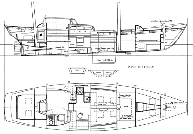

But in my fifth boat (T’IEN HOU), I hit on the solution: I was determined that the head should not be inside the boat… so I put it in the cockpit! This was certainly an unusual and somewhat controversial head/shower location. T’IEN HOU has a center-cockpit/pilothouse, located between the main saloon and the master’s aft sleeping cabin. I placed the head in a separate well lower than the cockpit, such that you step down into the head (it still has 6 feet standing headroom). The head and shower are therefore in their own small cabin, about the size of a large phone booth, or a small outhouse. The first and foremost reason for this choice was to completely eliminate disagreeable odors inside the boat! And it worked! No head odors whatsoever permeate any part of the interior.
Plan and inboard profile.
The Lorcha 50’s Plan & Inboard Profile, showing the head location to starboard in the cockpit (dashed lines in the profile view).
In the Plan View drawing of T’IEN HOU, the head is located just aft of the helm seat, in a central location convenient to every part of the boat, but especially to the aft sleeping cabin, cockpit/pilothouse, and main saloon. Crew members from the fo’c’s’le admittedly have a bit of a trek to reach it, which could be solved by installing a second head in the cargo hold (something I would never do). I simply cannot embrace the practice of installing more than one head in a modest-sized cruising boat.
