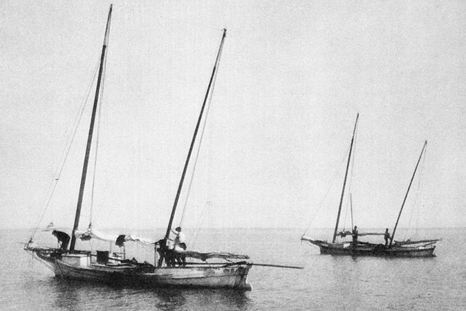

Chesapeake Bay brogans
Chesapeake Bay brogans circa 1901 from Chesapeake Bay Log Canoes and Bugeyes by M. V. Brewerton
(photo by George Barrie Jr.).
The missing link in the well-known evolution of Chesapeake Bay oyster fishermen is the Brogan. First came sailing log canoes, which are still extant on the Bay, and are raced very competitively to this day. Last came the bugeye and the skipjack—bugeyes are getting scarce, but skipjacks (AKA bateaux) still work the oyster beds under sail, and are among the last sailing workboats in the world.
The canoes, brogans and bugeyes were constructed of logs—some of the large bugeyes used as many as seven huge logs in their bottoms, with topsides framing and planking above. Skipjacks came about when the large trees required for bugeyes were all gone. They were built plank-on-frame.
The brogans were the direct ancestors of the bugeyes—also built with log bottoms and planked topsides, but smaller in size. The brogan rig, as seen in the photo above, continued to be used, on a larger scale, by the bugeyes and skipjacks, although most of the smaller skipjacks were sloop rigged.
