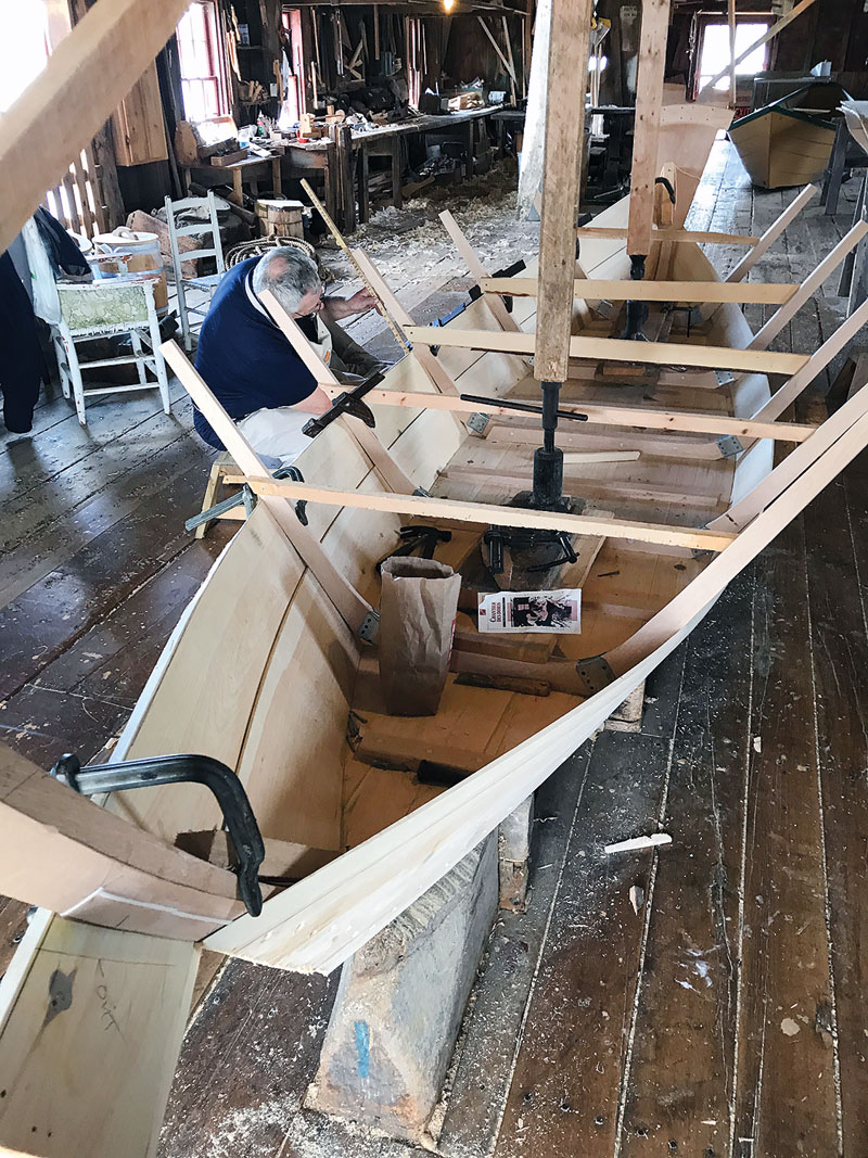

Milford Buchanan and I had already bent the pre-made bottom of the dory into the building jig—or horse, as he called the ancient cradle on the boatshop floor at the Dory Shop Museum in Shelburne, Nova Scotia. We had wedged the flat bottom tightly in place using posts and jacks that had been used to spring more than 50,000 bottoms to the standard 31⁄2" rocker. All five frames and even the stem and the transom were attached to the bottom before we bent it into place.
Now, I grabbed a spirit level and held it vertically alongside the stem to check it for plumbness. Buchanan looked at me and said, “I guess you could do it that way.” He took the level and set it on the workbench, then walked to the end of the shop and shut one of the bay doors. He returned to the boat. “See that stick on the edge of the door? Sidney Mahaney put that there. That’s plumb.” Mahaney had started building dories in this same building as a teenager, in 1914. Straddling the dory and squinting with one eye, Buchanan directed me to nudge the stem so that it would be plumb before securing braces to hold it there. That’s how it’s always been done here, where Buchanan, a fourth-generation boatbuilder, has carried on the tradition as the museum’s lead builder since 2003.
