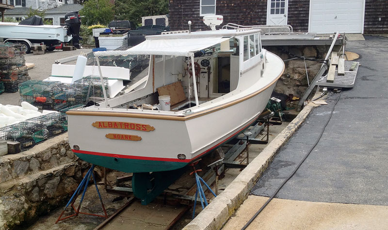

ALBATROSS looks right at home hauled out by owner Mike Coyle at a lobsterboat slip belonging to a relative in Noank, Connecticut. The boat was hauled only for routine below-the-waterline work; Coyle was able to do much of his work on the boat while she was still in the water.
