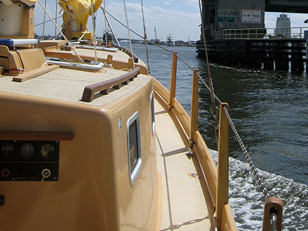

Tapered wooden stanchions.
Tapered wooden stanchions on the schooner LEOPARD.
When I designed and built my pilot schooner LEOPARD (1994), I again had to confront the lifeline issue, as I intended to make long ocean passages in all weather conditions. I was inspired by drawings of historic 18th-century American Navy ships in Howard Chapelle’s books, several of which had wooden stanchions and rope lifelines. I decided to design modern duplicates of these, using Dacron braid for lifelines instead of wire rope (or hemp).
I chose “Miami teak” (pressure-treated southern yellow pine) for my stanchion material, starting with nominal 4x4 stock. At the lumber yard, I searched through the stacks looking for older, dryer material that had cured without checking badly or twisting, with small fixed knots or none at all.
Stanchions with different types of bases.
Stanchions for the Lorcha 50 T’IEN HOU, showing different types of bases
I tapered my stanchions in width from 3½′ to 3″ at the heads; and tapered them in thickness from 2 ½″ to 2″ at the heads. I then rounded the heads to a 1″ radius, drilled them to 3/4″, for 5/8″ braided or plaited Dacron rope, and routed all edges (including the holes) to a 3/8″ or 1/2″ quarter-round. The large, rounded heads would be very unlikely to injure someone thrown against them. The dry wood readily soaked up several coats of Deks Olje #1 penetrating oil, which I later over-coated with Deks Olje #2 finishing oil. This two-step treatment looks like varnish when finished, but is softer and more durable, and much easier to refinish than varnish. Once a year you lightly wet-sand or rub the stanchions with the #1 oil, then coat with the #2 oil. Deks Olje is made by the Flood company; it is marketed as a two-part marine Danish oil product. It can take a real beating—sun, water, dings, chafe, etc—and can be touched up without sanding. For those who care: Deks Olje is pronounced “decks olya” and not “decks olay”.
At their bases, I attach my wooden stanchions to the vessel’s bulwarks with four stainless steel carriage bolts (typically ¼″). I also build my bulwarks (or toe rails) from pressure-treated wood, air-dried and stack-laminated with epoxy and lag bolts. They are very strong, and my stanchions are therefore very stiff. Sometimes I notch the stanchions to fit inside the bulwarks; sometimes I bevel them at the bases; and sometimes I notch them to fit outside the bulwarks (see photo above).
