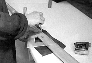

3. Next comes the most difficult part of the job: sizing and cutting the leather to fit the circumference of the oar. The best way to determine the circumference is to cut a sacrificial strip of leather, 1″ wide and long enough to go around the oar with a little to spare. Usually, oar looms are tapered, so you will need to determine the circumference of the oar at each end of the leather, and at the midpoint. To do this, wrap the sacrificial strip around the loom and pull it snug. Mark with a pen where the two ends of the finished oar leather would touch. Lay the strip out flat, measure the location of your mark from the end, subtract ¼″ from this measurement, and record the result. Do the same for the other two locations, remembering to subtract ¼″.
Now lay the raw leather out flat, rough side up, and with a pen and straightedge draw on it the shape of the finished leather according to your measurements. The shape must be symmetrical lengthwise, and the end near the blade will usually be narrower. Cut the piece out with very sharp scissors, and test its fit on the oar. There should be a ¼″ gap along the seam. If you like the fit, round off the four corners just a wee bit with the scissors. (Be sure to repeat all of this step for the second oar, because the two oars may not have the exact same circumference.
