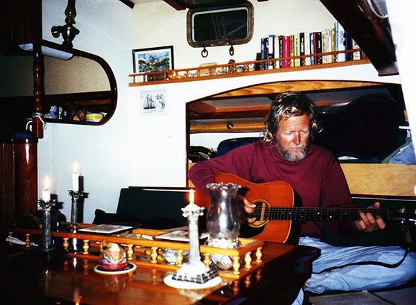

Aft cabin and saloon.
LEOPARD’s aft cabin & saloon; galley to left; the author crooning; pilot berth behind.
